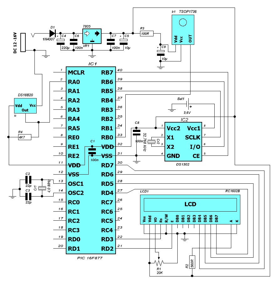

A következő problémával fordulok hozzátok: van egy DS1302 RTC-vel és PIC 16F877 épített órám, az RTC-t 2ms-os időnként olvasom ki, ha ellem nélkül, használom akkor naponta siet 2-3 másodpercet, de ha használom az elemet, akkor késik 6 – 7 percet. Ez vajon mitől lehet? Találtam a Maxim-nál leírást rá de az angol tudásom kevés hozzá, a fordítók meg egyszerűen értelmetlen fordítást adnak. Ha valaki le tudná fordítani, vagy tudna valami megoldást, azt megköszönném! Slow Clocks The following are the most common scenarios that cause a crystal-based RTC to run slow. 1. Overshoots on RTC input pins. It is possible to cause a RTC to run slow by periodically stopping the oscillator. This can be inadvertently accomplished by noisy input signals to the RTC. If an input signal rises to a voltage that is greater than a diode drop (~0.3V) above VDD, the ESD protection diode for the input pin will forward bias, allowing the substrate to be flooded with current. This, in turn, stops the oscillator until the input signal voltage decreases to below a diode drop above VDD. This mechanism can cause the oscillator to stop frequently if input signals are noisy. Therefore, care should be taken to ensure there is no overshoot on input signals. Another situation that is common to overshoot problem is having an input to the RTC at 5V when the RTC is in battery-backup mode. This can be a problem in systems that systematically shut down certain circuits but keep others powered up. It is very important to ensure there are no input signals to the RTC that are greater than the battery voltage (unless stated otherwise in the device data sheet) when the device is in battery-backup mode. 2. Wrong crystal. A RTC typically runs slow if a crystal with a specified CL is less than the CL of the RTC. The severity of the inaccuracy is dependent on the value of the CL. 3. Stray capacitance. Stray capacitance between the crystal pins and/or to ground can slow an RTC down. Therefore, care must be taken when designing the PC board layout to ensure the stray capacitance is kept to a minimum. 4. Temperature. The further the operating temperature is from the crystal turnover temperature, the slower the crystal oscillates. See Figures 3 and 4.

-Miért 2ms-onként olvasod? Nem elég másodpercenként? - Elem nélkül használod?? Akkor ne várj sokat tőle... Buktatók a DS RTC-vel (saját tapasztalatok): - Elem merül, vagy nincs - Túl nagy a felhúzó ellenállás (nálam a 2k2 az optimális) - Túl gyors a kiolvasás, nincs idő végrehajtani az utasításokat - Hiányzik az inicializálás vagy nem fut le - Egy megszakítás pont kiolvasás közben van és kiakad - Nyák hiba (zárlat és/vagy szakadás) - Nem megfelelő értékű kvarc (32,768KHz-es kell) Más elkövette azt a hibát, hogy 3,2768MHz-est tett be és 4 percet csúszott neki... - Hiányzik a 100nF-os kondi a táplábak mellől és zajos a táp - Extrém magas hőmérsékleten akarod használni. Pl.: Mellette van egy fet ami fűt mint állat... A fordításban tud segíteni a google is: Bővebben: Link
Köszi a tapasztalataidat, elvileg elég a mp-es olvasás is. Elemmel szeretném használni csak ha használom, akkor késik 6 -7 percet naponta. A felhúzó ellenállás hova kell? Mert én az adatlap szerint kötöttem össze a PIC-el de ott nem láttam. Természetesen 32.768 KHz óra kvarcot használok, próbapanelon összerakva szalagkábellel összekötve. 100nf szűrőkondit használtam a PIC-nél és a DS1302 IC-nél is.
Vdd es az adat labak hogy vannak bekotve? Jo lenne egy rajz, hogy lehessen latni. Tobb lehetseges dolgot emleget amugy amit beideztel. Pl. az bemeneti jel zajos, vagy tul magas szinten van. Vagy a kristaly nem jo, vagy a kondik nem megfelelo ertekuek. Vagy a parazita kapacitasok okoznak problemat (pl nem megfeleloen kialakitott vezetek/szigetelo reteg a panelon, tul messze van a kristaly stb).
Próbáld meg az 5,6,7-es lábakat felhúzni tápra, egy-egy darab 4k7~10K ellenállással. A kvarcnak közvetlenül az IC lábai mellett kell lenni, lásd az adatlap 5. oldalán.
Elkészítettem a rajzot, a kvarc közvetlenül az IC lábai mellett van!
Köszi Vicsys, megpróbálom 5,6,7 lábakat felhúzni tápra hátha változik.
