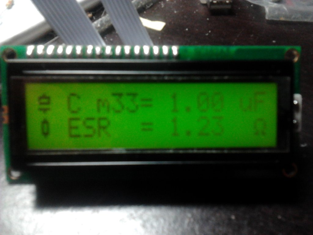

(#) Kasamiko hozzászólása Feb 10, 2012 /
Ok everything is working fine now..
Test capacitor is 1µF/16V electrolytic.
Meter reads:
C m33 = 1.00 uF
ESR = 1.23 ohms
Anybody care to tell me what is m33 all about?

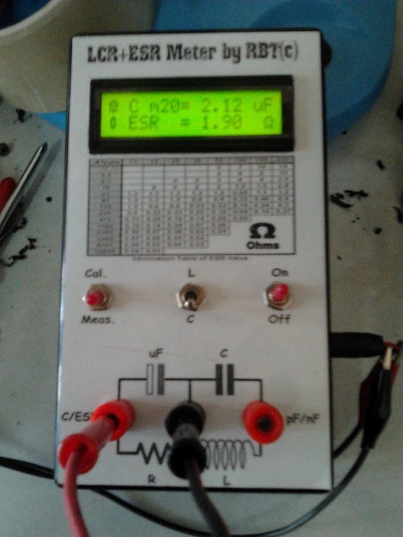

(#) Kasamiko hozzászólása Feb 11, 2012 /
Ok...it seems to be working fine now..
F0 = 502.9k
FCal = 360.9k
Here is my reading for 100µF/16Volts electrolytic
C m60 = 93.3 uF
ESR = 533 milliohm
What does m60 means?
(#) Hp41C válasza Kasamiko hozzászólására (») Feb 11, 2012 /
The memory effect of the capacitor. Charges the capacitor to a DC voltage, keeps it alone for a time, and checks for the voltage on the capacitor.
So what does it means? The higher the value the better is the capacitor?
BR
(#) abcdabcd válasza Kasamiko hozzászólására (») Feb 11, 2012 /
No, the lower the better, for m60 memory, i think its something like a bad cap removed from some power supply, a good electrolityc cap has about m20 or less, at least most ones i've checked had that value, and a really good one can have m1-2, these are mostly foil caps, but really really good electolityc ones can have that good values too.
Oh my! They are all brand new capacitors and never been used before..

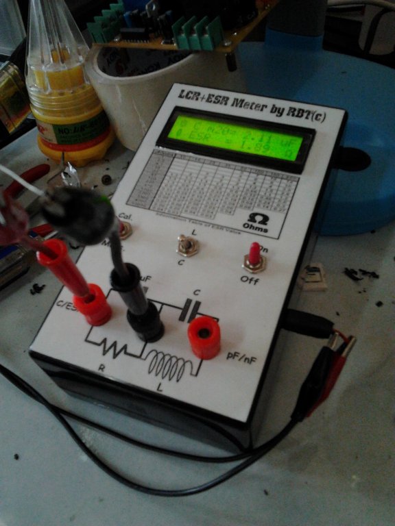

(#) Kasamiko hozzászólása Feb 22, 2012 /
Finally!
Working like charm!
(#) erdgab válasza Kasamiko hozzászólására (») Feb 22, 2012 /
Congratulations!
