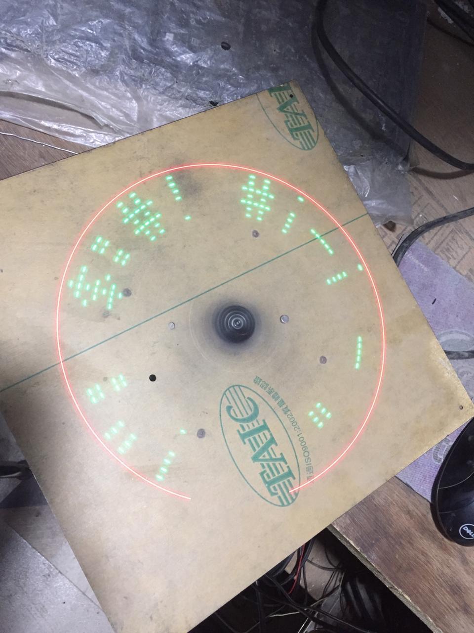

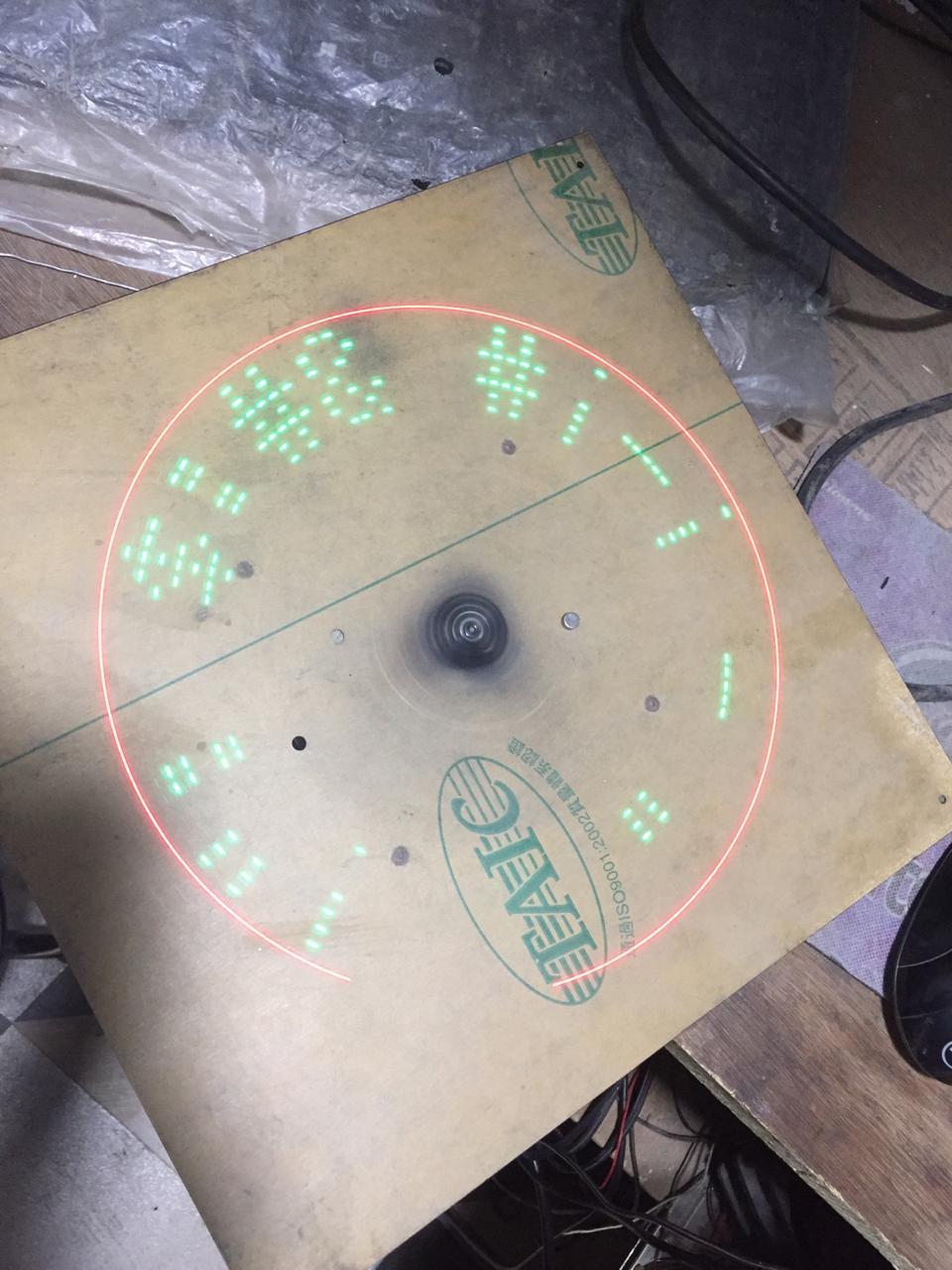

(#) Cidric válasza Cidric hozzászólására (») Nov 8, 2019 /
HI Hp41C
I NEED YOUR HELP PLEASE SEE THIS VIDEO AND TELL ME HOW CAN IFIX THIS PROBLEM
(#) Hp41C válasza Cidric hozzászólására (») Nov 9, 2019 /
Hi,
if this bug seen when displaing binany clock use the files attached.
Amennyiben a hiba a bináris kijelzés esetén látható, használjuk a mellékelt állományokat.
(#) Cidric válasza Hp41C hozzászólására (») Nov 9, 2019 /
HI Hp41C
THIS IN NOT BINARY CLOCK
CLOCK DONT SHOW TIME IN NUMERIC

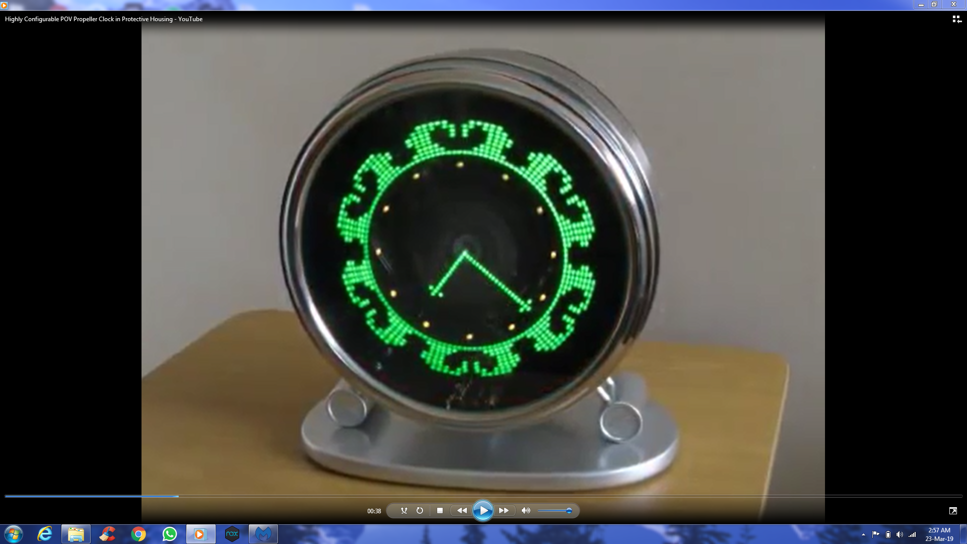

Hi,
I think the clock has set to sow time and date in binary format. The date on the 3.jpg in 20-01-13, the time is 12:07:47.
There was a bug in the version You have uploadad here.
  1. CharPatternTab
  2.                 btfsc   BCD_High,7
  3.                 goto    CharPatternBin
  4.                 movlw   high(CharTab)
  5. CharPattern                                             ; If calls out from lower 2K, afther call PCLATH has to be set to 0
  6.                 addwf   BCD_High,w              ; Get high byte
  7.                 movwf   PCLATH                  ; Store it in PCLATH
  8.                 movf    BCD,w                   ; Get low byte
  9.                 movwf   PCL                             ; Get next character
  10.
  11. ;=======================================================
  12. ; No execution passes here
  13.
  14. CharPatternBin                                  ; If calls out from lower 2K, afther call PCLATH has to be set to 0
  15.                 movlw   high(CharTab)   ; Get high byte
  16.                 movwf   PCLATH                  ; Store it in PCLATH , PCLATH has only 5 bits - bit7 of BCD removed
  17.                 movf    BCD,w                   ; Get low byte
  18.                 addlw   low(CharTab)-(6*('0'-' ')) ; Convert start address of character
  19.                 movwf   PCL                             ; Get next character
As You can see the same table was used for normal characters and binary characters. The result of this bug is, when set to binary mode, the numbers are converted to first 10 characters starting with space. (space , ! , " , # , $ , % , & , ' , ( , ) , * , + , coma , - , dot , / )
Binary mode is controlled by bit 4 of flags5 and controlled with IR command "TBinMode".
Try to disable binary mode by modifing the folowing part
  1. l_BCD
  2.                 andlw   0x0F                    ;
  3.                 bcf             STATUS,RP1              ; Bank0
  4. ;l_mult6
  5.                 movwf   BCD                             ;
  6.                 addwf   BCD,f                   ; BCD = BCD * 2
  7.                 sublw   .9                              ; w = 9 - BCD
  8.                 btfss   STATUS,C                ; Check for decimal character (A..F converted to space)
  9.                 goto    l_Space
  10.                 movf    BCD,w                   ; W = BCD * 2
  11.                 addwf   BCD,w                   ; W = BCD * 4
  12.                 addwf   BCD,w                   ; W = BCD * 6
  13.                 addlw   6*('0'-' ')             ; Convert to character code, C=0
  14.                 btfsc   flags5,4                ; Test for binary mode
  15.                 bsf             BCD_High,7
  16.                 goto    l_dot
to
  1. l_BCD
  2.                 andlw   0x0F                    ;
  4. ;l_mult6
  5.                 movwf   BCD                             ;
  9.                 goto    l_Space
  14.                 bcf             BCD_High,7
  15.                 goto    l_dot

(#) Cidric válasza Cidric hozzászólására (») Nov 9, 2019 /
work fine sir thank you so much
