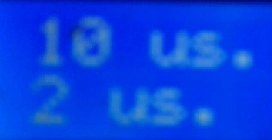

Akkor kíváncsiságból lefuttatnád ezt a teszt programot:
  1. #include <LiquidCrystal_I2C.h>
  2. LiquidCrystal_I2C lcd(0x27, 16, 2);
  3.
  4.
  5. byte gomb1 = 2;
  6. byte gomb2 = 3;
  7. byte gomb3 = 4;
  8. byte gomb4 = 5;
  9. byte gomb5 = 6;
  10. byte gomb6 = 7;
  11. byte gomb7 = 8;
  12. byte gomb8 = 9;
  13.
  14. unsigned long starttime, stoptime, eltelttime, eltelttime2 ;
  15.
  16. void setup() {
  17.   pinMode(gomb1, INPUT);
  18.   pinMode(gomb2, INPUT);
  19.   pinMode(gomb3, INPUT);
  20.   pinMode(gomb4, INPUT);
  21.   pinMode(gomb5, INPUT);
  22.   pinMode(gomb6, INPUT);
  23.   pinMode(gomb7, INPUT);
  24.   pinMode(gomb8, INPUT);
  25.   lcd.init();
  26.   lcd.backlight();
  27.
  28.   starttime = micros();
  29.   int gomb1val_ = digitalRead(gomb1);
  30.   int gomb2val_ = digitalRead(gomb2);
  31.   int gomb3val_ = digitalRead(gomb3);
  32.   int gomb4val_ = digitalRead(gomb4);
  33.   int gomb5val_ = digitalRead(gomb6);
  34.   int gomb6val_ = digitalRead(gomb5);
  35.   int gomb7val_ = digitalRead(gomb7);
  36.   int gomb8val_ = digitalRead(gomb8);
  37.   stoptime = micros();
  38.   eltelttime = stoptime - starttime;
  39.   lcd.setCursor(0, 0);
  40.   lcd.print(eltelttime);
  41.   lcd.print(" us.");
  42. // controller-ben digitalRead(gomb1);gyorsítása:
  43. // Be olvassa a GPIO regisztert és kimaskolja a megfelelő bitet
  44.   starttime = micros();
  45.   uint8_t  gomb1val = ((uint32_t)PIOB->PIO_PDSR & 1u << 25)>> 25  ;// D2 = B.25
  46.   uint32_t  PioC = PIOC->PIO_PDSR ;
  47.   uint8_t  gomb2val = (PioC & 1u << 28)>> 28  ;// D3 = C.28
  48.   uint8_t  gomb3val = (PioC & 1u << 26)>> 26  ;// D4 = C.26
  49.   uint8_t  gomb4val = (PioC & 1u << 25)>> 25  ;// D5 = C.25
  50.   uint8_t  gomb5val = (PioC & 1u << 24)>> 24  ;// D6 = C.24
  51.   uint8_t  gomb6val = (PioC & 1u << 23)>> 23  ;// D7 = C.23
  52.   uint8_t  gomb7val = (PioC & 1u << 22)>> 22  ;// D8 = C.22
  53.   uint8_t  gomb8val = (PioC & 1u << 21)>> 21  ;// D9 = C.21
  54.   // A kapott értéket eltoljuk jobb szélre bit.0-ba
  55.   stoptime = micros();
  56.   eltelttime2 = stoptime - starttime;
  57.   lcd.setCursor(0, 1);
  58.   lcd.print(eltelttime2);
  59.   lcd.print(" us.");
  60.   eltelttime2 = eltelttime - eltelttime2;
  61.   lcd.setCursor(0, 2);
  62.   lcd.print("elteres: ");
  63.   lcd.print(eltelttime2);
  64.   lcd.print(" us.");
  65. }
  66.
  67. void loop() {
  68.   // put your main code here, to run repeatedly:
  69.
  70. }
Ki írja az LCD-re a két gomb kezelés futás idejét, és a különbséget.
(#) Rober_4 válasza kapu48 hozzászólására (») Máj 15, 2020 /
Tíz illetve kettő mikroszekundumot mutat. Ez mindenképpen jelentős különbség.
(#) kapu48 válasza Rober_4 hozzászólására (») Máj 15, 2020 /
Igen.
Mivel csak 2us-enként van 1 megszakítás, ennél kevesebb időt nem is tudunk mérni.

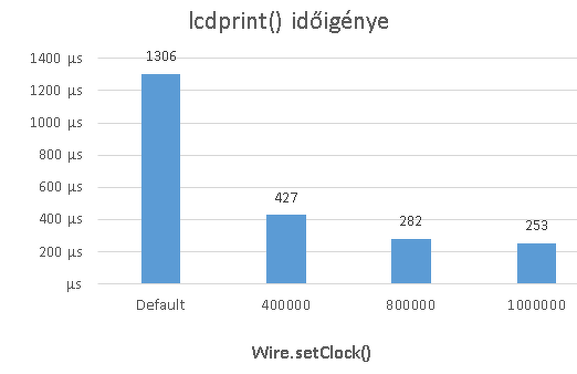

(#) Rober_4 válasza Rober_4 hozzászólására (») Máj 15, 2020 /
Viszont találtam még tempót az LCD írásnál.
Rámértem a programban az eltelt időkre több clock frekvenciával, nyerek harminc milliszekundumot ha felteszem 1 MHz-re 800 kHz-ről! Csináltam diagramot, hátha hasznos még valakinek...
A hozzászólás módosítva: Máj 15, 2020

(#) mateatek válasza benjami hozzászólására (») Máj 16, 2020 / 1
Az én LiquidCrystal_I2C.cpp fájlomban nincsen benne ez a késleltetés.
I2C-vel hajtott kijelzőn a következő kód 3404 mikroszekundum alatt fut le. 32 MHz-es órajelen 2500 mikroszekundumig tudom lefaragni:
  1. lcd.setCursor(0, 0);
  2.   lcd.print("01234567");
  3.   lcd.setCursor(0, 1);
  4.   lcd.print("01234567");
Ha valaki gyorsan lefuttatna egy tesztet egy másik rendszeren, az tényszerűen mutatná a sebességeket.
(#) mateatek válasza mateatek hozzászólására (») Máj 16, 2020 / 1
Addig-addig találtam itthon egy vasat, amin a "6 vezetékes" rendszerrel van a kijelző. 5048 mikroszekundum alatt futott le a fenti kódrészlet.
Tehát, szerintem gyorsabb az I2C, de a 8 bites vezérlés kipróbálása még vissza van.

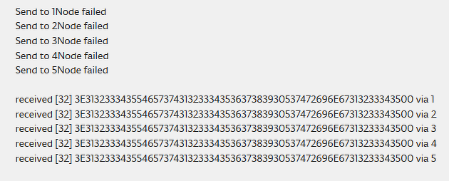

(#) Bell hozzászólása Máj 16, 2020 /
A legfrissebb Arduino-val, a legfrissebb RF24-el, Pro-micro-kal, NRF24L01+ kínai klónokkal szeretném az "ack"-ot kijelezni az adó oldalon.
De az itt található (Bővebben: Link) leírás és a programok segítségével ez nem sikerül.
A radio.write(...) sosem ad igaz értéket.
Kondi van a modulokra forrasztva. Mit rontok el? A modullal lehet gond, vagy a programmal?
Az RX programja:
  1. #include <RF24.h>
  2. #include <SPI.h>
  3.
  4. const byte rAddress[] =  "1Node" "2Node" "3Node" "4Node" "5Node";
  5. byte ackData = 1;
  6. byte theMessage[32];
  7.
  8. RF24 radio(8, 10);
  9.
  10. void loadAckData(byte pipe) {
  11.   radio.writeAckPayload(pipe, &ackData, sizeof(ackData));
  12.   ackData++;
  13. }
  14.
  15. void setup(void) {
  16.   Serial.begin(9600);
  17.   radio.begin();
  18.   radio.setChannel(108);
  19.   radio.setDataRate( RF24_2MBPS );
  20.   radio.enableAckPayload();
  21.   radio.enableDynamicPayloads();
  22.   for (byte i = 0; i < 5; i++) {
  23.     radio.openReadingPipe(i + 1, &rAddress[i * 5]);
  24.   }
  25.   loadAckData(2);
  26.   loadAckData(3);
  27.   loadAckData(4);
  28.   radio.startListening();
  29. }
  30.
  31. void loop(void) {
  32.   byte pipeNum = 0;
  33.   if (radio.available(&pipeNum)) {
  34.     if (pipeNum == 2 || pipeNum == 3 || pipeNum == 4) {
  35.       loadAckData(pipeNum);
  36.     }
  37.     byte len = radio.getDynamicPayloadSize();
  38.     radio.read(theMessage, len);
  39.     Serial.print(F("received ["));
  40.     Serial.print(len);
  41.     Serial.print(F("] "));
  42.     for (int x = 0; x < len; x++) {
  43.       if (theMessage[x] < 16) {
  44.         Serial.write('0');
  45.       }
  46.       Serial.print(theMessage[x], HEX);
  47.     }
  48.     Serial.print(F(" via "));
  49.     Serial.println(pipeNum);
  50.   }
  51. }
A TX programja:
  2. #include <SPI.h>
  3.
  4. const byte wAddress[] =  "1Node" "2Node" "3Node" "4Node" "5Node";
  5. byte testData[32] = ">12345Test1234567890String12345";
  6. byte ackMessg;
  7.
  9.
  10. void setup(void) {
  11.   Serial.begin(9600);
  12.   radio.begin();
  13.   radio.setDataRate( RF24_2MBPS );
  14.   radio.setChannel(108);
  15.   radio.enableAckPayload();
  16. }
  17.
  18. void loop() {
  19.   static byte index = 0xFF;
  20.   static unsigned long lastSend;
  21.   unsigned long topLoop = millis();
  22.   if (topLoop - lastSend >= 1000) {
  23.     lastSend = topLoop;
  24.     if (++index > 4) {
  25.       index = 0;
  26.     }
  27.     const byte* ptr = &wAddress[index * 5];
  28.     radio.openWritingPipe(ptr);
  29.     if (radio.write(testData, sizeof(testData))) {
  30.       if (radio.isAckPayloadAvailable() ) {
  31.         radio.read(&ackMessg, sizeof(ackMessg));
  32.         Serial.print(F("Acknowledge for "));
  33.         for (byte i = 0; i < 5; i++) {
  34.           Serial.write(*ptr++);
  35.         }
  36.         Serial.print(F(" received: "));
  37.         Serial.println(ackMessg);
  38.       }
  39.     } else {
  40.       Serial.print(F("Send to "));
  41.       for (byte i = 0; i < 5; i++) {
  42.         Serial.write(*ptr++);
  43.       }
  44.       Serial.println(F(" failed "));
  45.     }
  46.   }
  47. }
