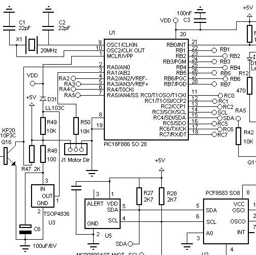

input DATA ?
data - > diod - > 12kom - > 6 pin lm358
J1 motor dir ?

(#) Hp41C válasza m_ix hozzászólására (») Dec 15, 2012 /
In that version of program the motor dir jumper and data input not used - reserved for development...
Pin 3 of TSOP4836 is it's the power supply pin. This circuit uses a low pass filter (R48 - C6) to supply this component.
(#) m_ix hozzászólása Dec 15, 2012 /
для 886 диод D31 не будет помехой для приёма комманд с пульта дистанционного управления?
for 886 diode D31 will not be an obstacle to receiving commands from the remote control?
During normal operation R49 and D31 pulls PIC's MCLR input to high level. If there is an infared activity causing output of TSOP to go low, D31 pulls MCLR low (+0.3V). In ICSP mode, MCLR would get +12 .. 13.5V from the programmer. Output of TSOP can't stand this voltage, but D31 blocks it.
