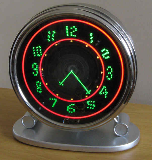

Hi Everyone
I'd like to share with everyone my version of the Prop_886_SMD Propeller Clock by Hp41C made using non-smd parts on prototype stripboard. I've attached some photos and videos of the clock both operating and stationary, and hopefully these can give some ideas to people who are thinking of building a similar clock. I think the most important thing I learnt was to put the spinning rotor in some sort of container. This has 3 advantages: 1) It greatly reduces the generated 'wind noise' when the clock is spinning at higher speeds 2) It provides protection against personal injury/damage to the clock 3) The rotation speed of the fan increases by between 10% and 20% for the same input power to the motor The container I used to put the spinning rotor in was a steel cake tin (as used in the kitchen) with a clear lid. Bővebben: Link http://www.marksandspencer.com/Stainless-Steel-Cake-Tin-Set/dp/B003FWJAME I then cut out most of the back of the tin and fitted a circular piece of clear acrylic to the cut out hole. Finally I cut out an oval shape from a piece of MDF wood and painted it a silver colour to match the colour of the cake tin. This painted wood was fitted to the cake tin via PCB spacers and acted as the base. Also, there is an option to put a dark piece of plastic over the back of the clear acrylic if the user wants a dark background (high contrast display) instead of a transparent background to the clock. Next I'll be making Kly's amazing Stargate Propeller Clock on prototype stripboard !!! P.S. I'm sorry I don't speak Hungarian, I am from the U.K. Ging
Great idea to use a caddy box as a cover. Very nice design. Congratulations.
Thanks you for your comments. Hp41C did all the hard work however - it is great firmware from him and many thanks must go to him.
Here is a YouTube video of my clock: Bővebben: Link
This is true. Without him it would be this nice project! Thanks to him, too!

Tényleg elképesztően jól néz ki így megépítve mint ahogyan ging elkészítette ehhez csak gratulálni lehet

Ha jól néztem a fényképet, nincs lenyomtatva, raszteres panelre készült. Egy rotoron két kontroller van egy 18F886 -os és egy 16F628 -as. Az index érzékelés, az infra vevő és a tápellátás közös...
Bár nem tőlem kérdezted de szerintem az index érzékelést simán össze lehet közösíteni, így szinte korlátlan számú kontroller összeköthető és ezzel biztosítva van a kijelzés szinkron közöttük. Persze ez elég favágó viszont nagyon fifikás és remek megoldás. Sajnos így nem lehet egybefüggő képet alkotni amit "egy" kontroller vezérel de arra jó, hogy az egyik PIC az órát ,a másik pedig a körülötte lévő animációt vagy szövegeket rajzolja. Így olyan érzésed van mintha többet tudna az óra de ez igazából optikai csalás
![]() Persze lehet ,hogy nem így oldotta meg és valós adatkapcsolat van a két PIC között. Mindenesetre nagyon jól sikerült , le a kalappal. Nem kispályás a srác, szerintem látni fogunk még tőle érdekes dolgokat.

A válasz mindvégig itt volt a kérdés felett: Idézet: „Az index érzékelés, az infra vevő és a tápellátás közös...”
Azért ez egy érdekes megoldás nem? Bár felvet egy csomó problémát is pl mi van ha nincs szinkron a két PIC között az infra vételben , vagy az idő másképp jár az I2C kiolvasást követően. Egyébként kinek az ötlete volt? Te írtad neki a módosított kódot? Régebben és is akartam "dual core" órát csinálni (persze nem így, valódit) amikor az RGB verziót terveztem de végül is nem csináltam meg mert a tapasztalat azt mutatta hogy elég egy db 40MIPS-es PIC teljesítménye is. Lassan előveszem én is újra az RGB-st . Szegény ott porosodik egy cipős dobozban. Úgy megjött a kedvem a programozáshoz ![]()

Ez két független rotor, az infra és az index közös, a két pic nem kommunikáll egymással. Alig történt módosítás a 16F886 -os rotoron. Csak 1 db RTC van rajta. Az összesített kapcsolási tervet nem én készítettem.
