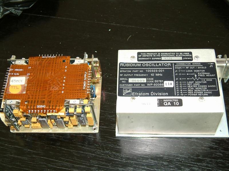

(#) sooty válasza p_istvan hozzászólására (») Szept 28, 2010 /
Tegyünk bele ilyet, ez legalább pontos "A rubidium clock has an accuracy of about ą1 x 10-12 so the error after a day would be 84.6ns (84e-9 seconds 84 billionths of a second!) so the error after a month would be 2.6us. Again using ppm is also inconvenient for writing : 0.000001ppm" :yes: (50-100$ szállítással)
