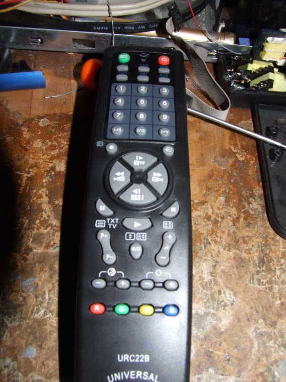

(#) KKobra hozzászólása Ápr 13, 2012 /
Valamit nem jól csinálok vagy a távim nem jó (URC 22b) vagy legalább is ez van ráírva . Nem úgy néz ki mint itt a fórumon láttam képet róla. Nem tudom rendesen vezérelni vele a régi órámat Megmondaná valki milyen Hex-et kellene a propra tenni és mit a bázisra hogy ne legyenek gondjaim az irányítással ? Most működik félig meddig néhány funkció megvan de ez így nem az igazi. így néz ki a távim[code

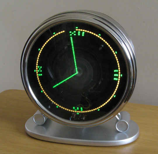

(#) ging hozzászólása Ápr 15, 2012 /
Hi Everyone
I'd like to share with everyone my version of the Prop_886_SMD Propeller Clock by Hp41C made using non-smd parts on prototype stripboard. I've attached some photos and videos of the clock both operating and stationary, and hopefully these can give some ideas to people who are thinking of building a similar clock. I think the most important thing I learnt was to put the spinning rotor in some sort of container. This has 3 advantages:
1) It greatly reduces the generated 'wind noise' when the clock is spinning at higher speeds
2) It provides protection against personal injury/damage to the clock
3) The rotation speed of the fan increases by between 10% and 20% for the same input power to the motor
The container I used to put the spinning rotor in was a steel cake tin (as used in the kitchen) with a clear lid.
http://www.marksandspencer.com/Stainless-Steel-Cake-Tin-Set/dp/B003FWJAME
I then cut out most of the back of the tin and fitted a circular piece of clear acrylic to the cut out hole. Finally I cut out an oval shape from a piece of MDF wood and painted it a silver colour to match the colour of the cake tin. This painted wood was fitted to the cake tin via PCB spacers and acted as the base. Also, there is an option to put a dark piece of plastic over the back of the clear acrylic if the user wants a dark background (high contrast display) instead of a transparent background to the clock.
Next I'll be making Kly's amazing Stargate Propeller Clock on prototype stripboard !!!
P.S. I'm sorry I don't speak Hungarian, I am from the U.K.
Ging
(#) Hp41C válasza ging hozzászólására (») Ápr 15, 2012 /
Great idea to use a caddy box as a cover. Very nice design. Congratulations.
(#) vicsys válasza ging hozzászólására (») Ápr 15, 2012 /
Wow! Fantastic! Congratulation!

Jó Lenne ha ging megosztaná velünk a kapcsolási rajzot nyáktervet hogy mi (én) is megépíthessük így
(#) Hp41C válasza KKobra hozzászólására (») Ápr 17, 2012 /
Ha jól néztem a fényképet, nincs lenyomtatva, raszteres panelre készült. Egy rotoron két kontroller van egy 18F886 -os és egy 16F628 -as. Az index érzékelés, az infra vevő és a tápellátás közös...

Vajon hogyan kombinálta össze két külön óra egyben?
A kép alapján KB 40 ledet vezérel vagy 2x18 at vagy 1x18 és 1x20. Azért lenne érdekes mert ezt meglehetne építeni pillanat forrasztóval is egyenlőre nekem más nincs.
Szoftveresen hogyan hozta össze hogy pontos legyen a kijelzés?
(#) kly válasza KKobra hozzászólására (») Ápr 18, 2012 /
Bár nem tőlem kérdezted de szerintem az index érzékelést simán össze lehet közösíteni, így szinte korlátlan számú kontroller összeköthető és ezzel biztosítva van a kijelzés szinkron közöttük. Persze ez elég favágó viszont nagyon fifikás és remek megoldás. Sajnos így nem lehet egybefüggő képet alkotni amit "egy" kontroller vezérel de arra jó, hogy az egyik PIC az órát ,a másik pedig a körülötte lévő animációt vagy szövegeket rajzolja. Így olyan érzésed van mintha többet tudna az óra de ez igazából optikai csalás .
Persze lehet ,hogy nem így oldotta meg és valós adatkapcsolat van a két PIC között.

(#) Hp41C válasza kly hozzászólására (») Ápr 18, 2012 /
Ez két független rotor, az infra és az index közös, a két pic nem kommunikáll egymással. Alig történt módosítás a 16F886 -os rotoron. Csak 1 db RTC van rajta.
Az összesített kapcsolási tervet nem én készítettem.
