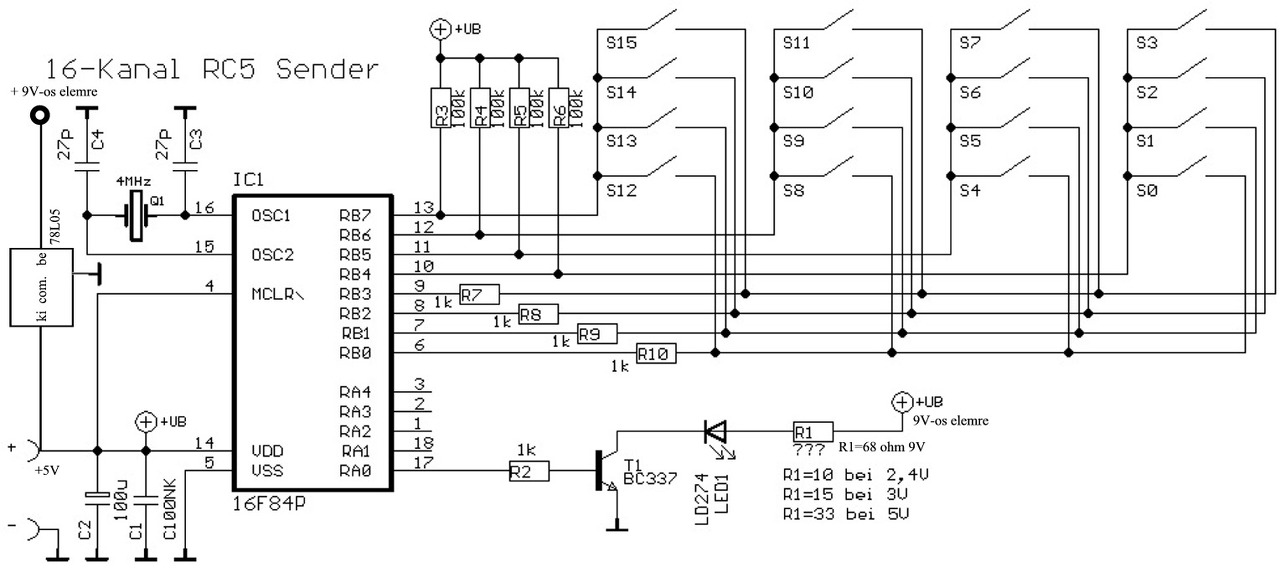

(#) janigel válasza Pritam hozzászólására (») Feb 11, 2018 /
This can be a good solution to the wiring diagram.
Read more: Link

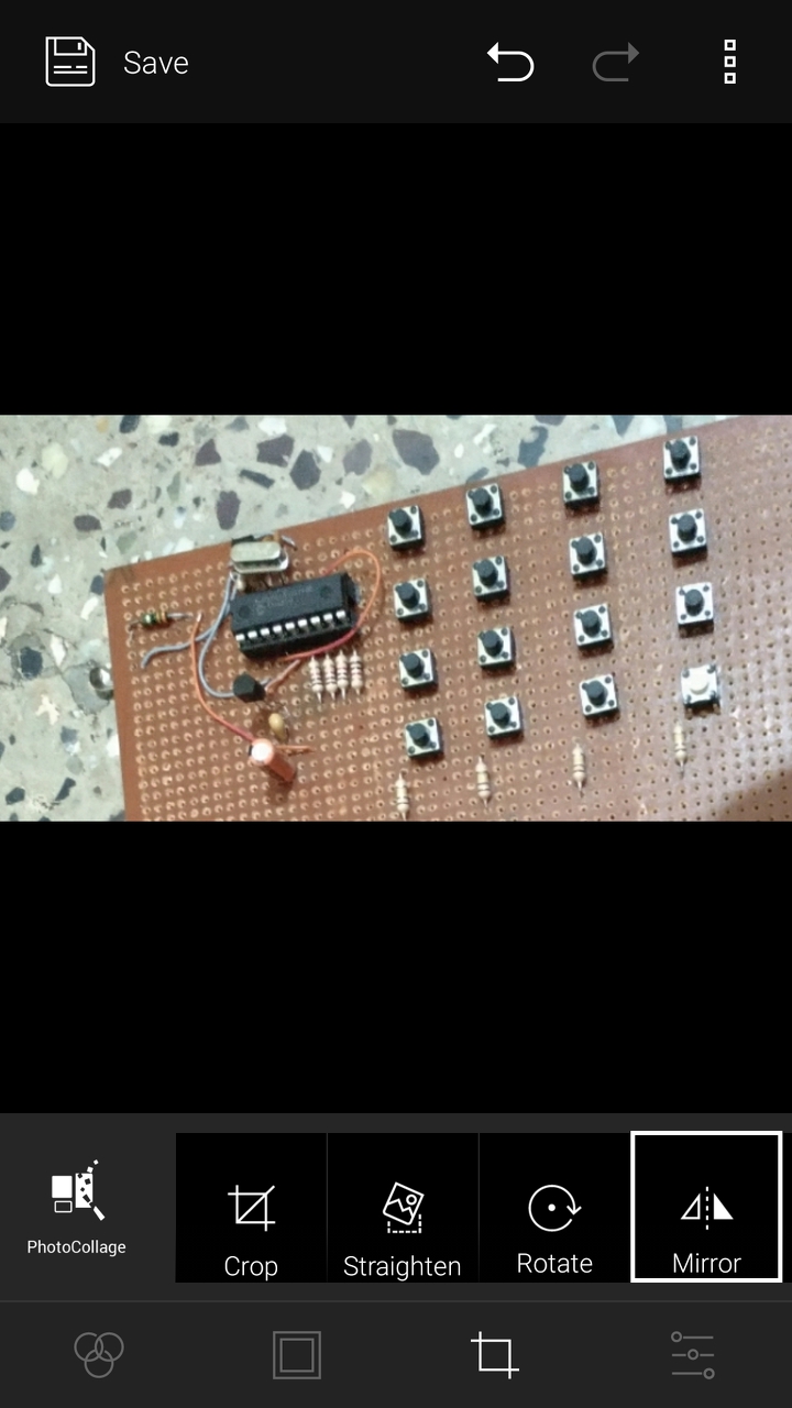

(#) Pritam hozzászólása Feb 11, 2018 /
Hi ,
Thanks for quick reply.
Actually I already make this remote with this drawing.
My clock also working fine.
Only some times, buttons needs to press 2 or 3 times.
Actually,I wanted some upgraded version .
Here is my Remote.
HI!
Both should be replaced.
New Type: TSOP4836 = 36 Khz
Test.

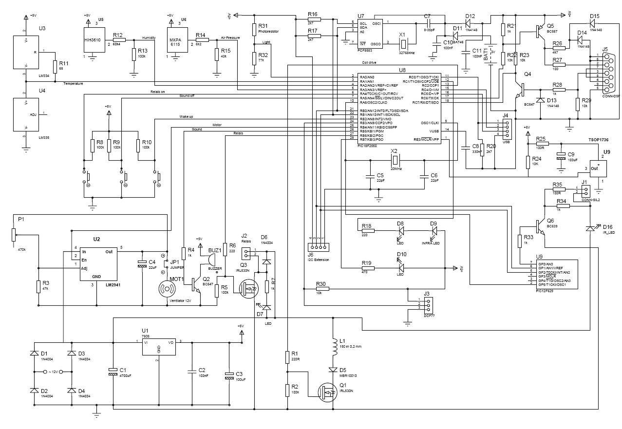

(#) Pritam hozzászólása Feb 12, 2018 /
Hi,
Ok, Tomorrow I will be replaced both and then check it .
Please tell me that is it working with following schematic (including Rtc)
or original schematic ?
Thanks..
(#) (Felhasználó 122012) válasza Pritam hozzászólására (») Feb 12, 2018 /
The wiring diagram is small, not seeing anything.
(#) Hp41C válasza (Felhasználó 122012) hozzászólására (») Feb 12, 2018 /
Let's use the search function on this forum (Keresés).
Here are the results searching for "prop_628" in file attachements.

(#) Hp41C válasza Pritam hozzászólására (») Feb 12, 2018 /
Base with 16F628A, 16F648A, 16F88:
schematics
Program version 2.18 in the attachement.
RC5 remote control:
schematics
program
Rotor with 16F628A, 16F648A:
program
Base.asm
(#) Pritam hozzászólása Feb 13, 2018 /
Hi again.
Thanks for replying.
Base schematic is very small. Can't see anything .
Please send big one.
Now I have material for Rotor and Remote control and I am going to make Rotor and Remote.
Can you please send me .lay files for all ?
I am also trying to make PCB at home .
Thanks again ..
PRITAM .

(#) Hp41C válasza Pritam hozzászólására (») Feb 14, 2018 /
Sorry for the link. Here is a larger one.
About the pcbs:
Since when this version was built and tested i was not practiced in making PCBs i have not lay files. The PCB depends on what kind of parts You can use, what case to fit. You can find several plans on this forum. Try to search (keresés) in flie attachements (fájlmellékletben).

(#) Hp41C válasza Pritam hozzászólására (») Feb 15, 2018 /
Hi,
the remote control program sends packets with modulation at 36kHz so use of TSOPxx36 with 36 kHz center frequency is the best choice. Since TSOP17xx feshioned out any replacement part with 5V Vss, 36kHz center frequency can be used but the pinout of these devices can be different.
IR LED can be used on the base, IR phototransistor can be used on the rotor to detect the rotation.

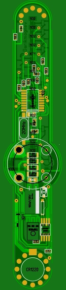

(#) garikmogilev hozzászólása Feb 16, 2018 /
My version PCB of the propeller clock 16F628A. Some ideas are borrowed from the pcb Patexati. For LEDs 0805. Due to the small size of the board, the zener diode is eliminated and the capacitor is inserted at a higher voltage. Phototransistor used ordinary, artificial lighting does not affect. The PCB is assembled and tested. The holes serve as a conductor from the coil, when using the hdd motor, you need to come up with another solution.
