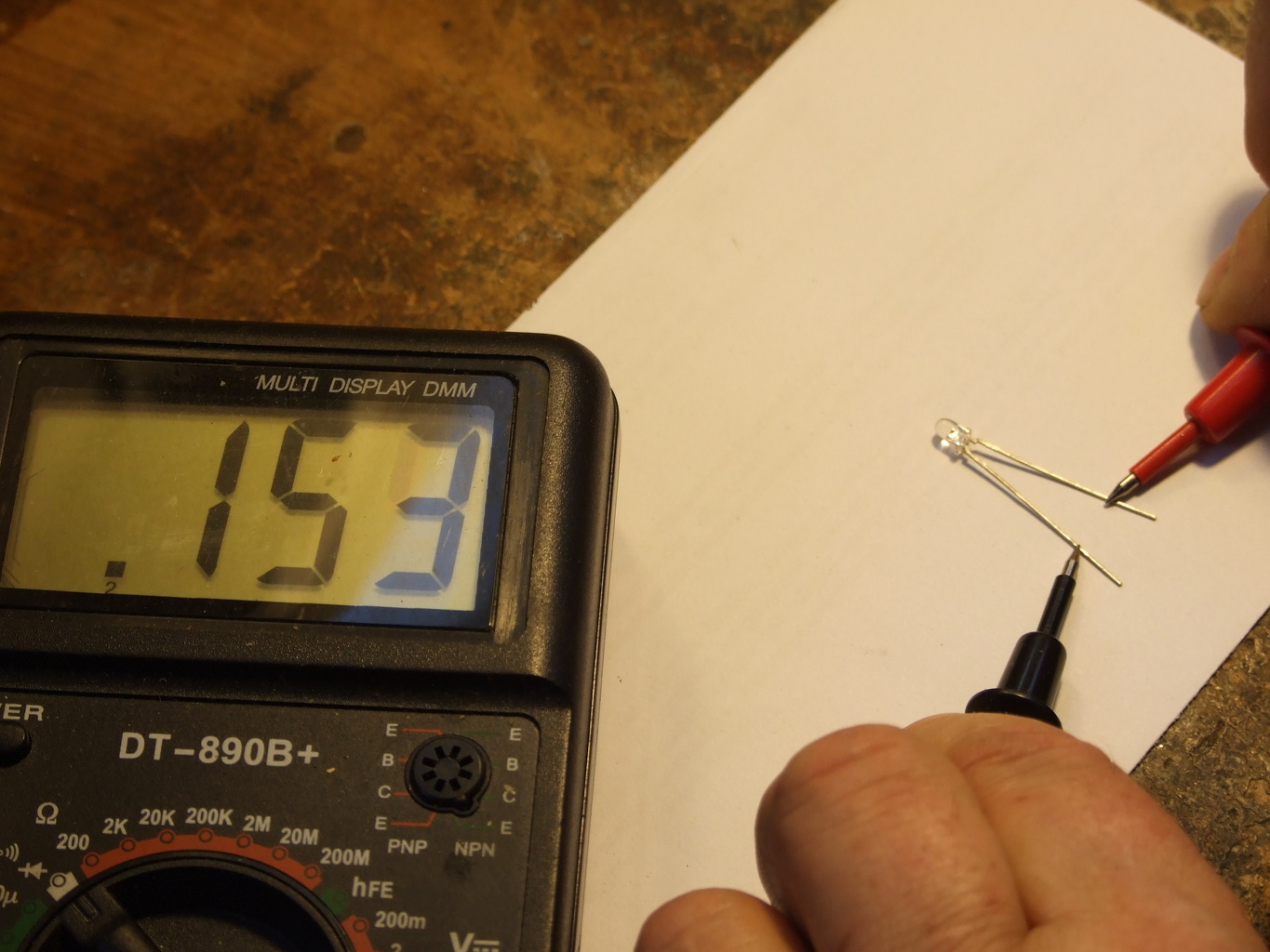

how can I probe the phototransistor in the air with an ohmmeter?
(#) Hp41C válasza Arsenic hozzászólására (») Jan 11, 2014 /
With a supply (5V) a resistor and the phototransistor make the circuit similer in rotor. Measure voltage on the collector of the phototransistor. With no light the voltage should be over 4.0V, alighted the voltage should be under 0.8V. May be the wave length of IR led and the sensitive range of phototransistor don't match.
Have you isolated the RB0 pin of PIC from the supply?
(#) KKobra válasza Arsenic hozzászólására (») Jan 11, 2014 /
be without any extra lighting illuminated high resistance low.
Or turning right polarity +5 V and 480Ω resistor and an LED illuminates the IR-aware transistor or a LED or light up or not
(#) Arsenic hozzászólása Jan 11, 2014 /
Nothing changes. I have a new one, but I don't know if this is a phototransistor or photo led. How can I note the difference?
(#) Arsenic hozzászólása Jan 11, 2014 1 /
Nevermind... the photo-transistor was broken. Now I have 4V with light and 0V without light... well, this problem solved, but the lights starts for a while, then shut down on every ON/OFF button pressing. Look at the video.

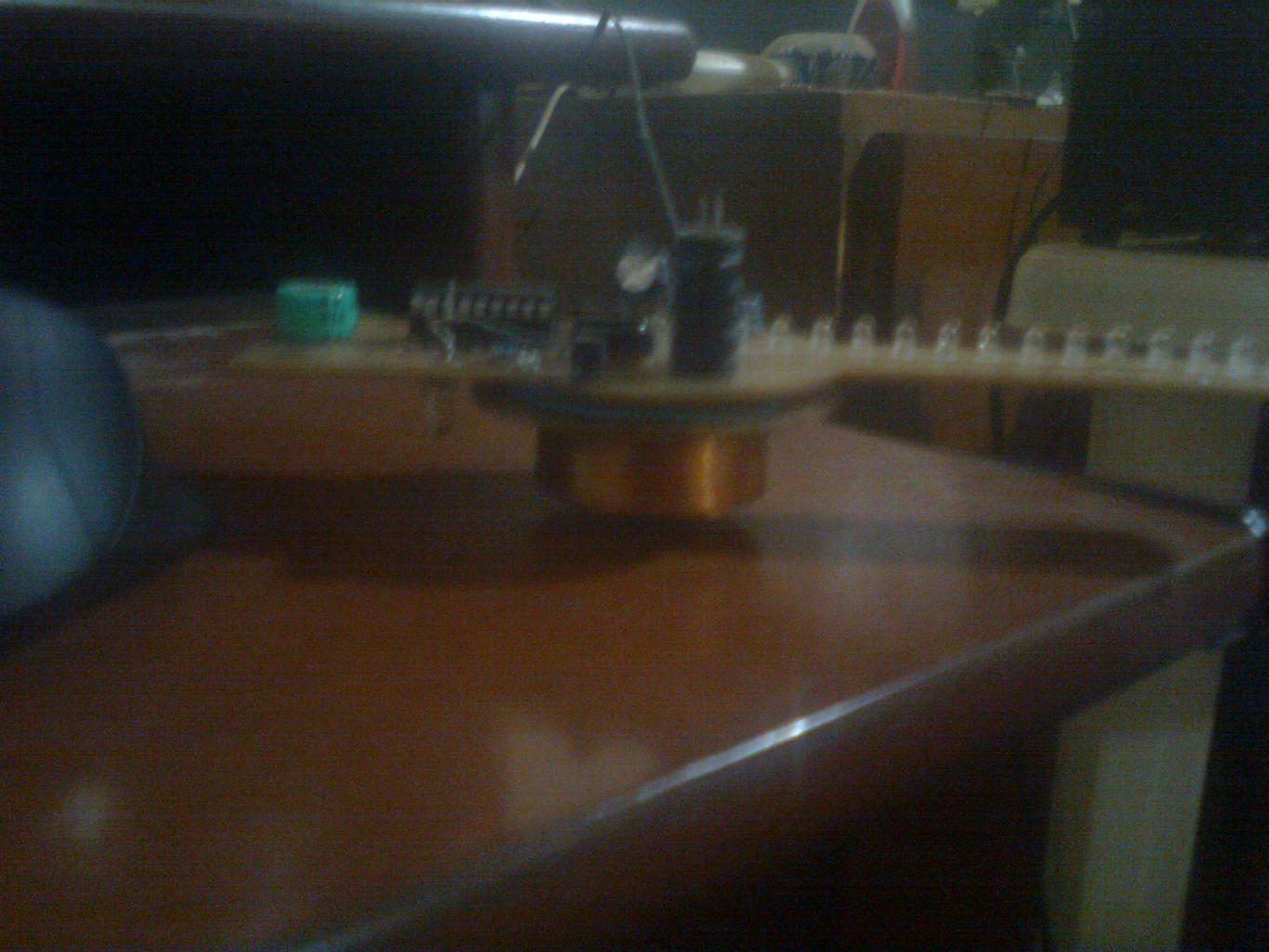

(#) vicsys válasza Arsenic hozzászólására (») Jan 11, 2014 /
Heavy is not problem. First, very important the rotor balancing...
(#) Arsenic válasza vicsys hozzászólására (») Jan 11, 2014 /
You mean this? (see picture) I can make that this keep like this adding some things to the board...
A hozzászólás módosítva: Jan 11, 2014
I said, balancing horizontally and vertically. You can use weights, screws or soldering tin.
